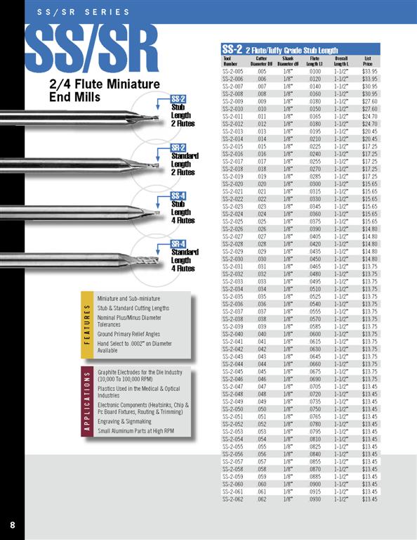

Anthony, did you only look at the woodworking catalog, check out the main catalog, the first several pages have sizes as small as 0.005" with 1/8" shank bits. Actually, most of the series of end mills have 1/8" shank bits. They have more than you could shake a stick at. 2 flute, 3 flute, 4 flute, ball end mills etc...

Thanks Rod -- are they upcut or downcut spirals?

[QUOTE=Anthony Z] Thanks Rod -- are they upcut or downcut spirals?[/QUOTE]
You can get both
