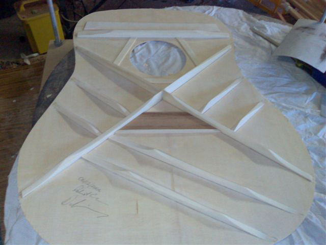

Braced top - the finger braces are sort of parabolic. the intention here is to keep mass in the centre of the soundboard. There's also a little "Mario" brace behind the bridge plate.

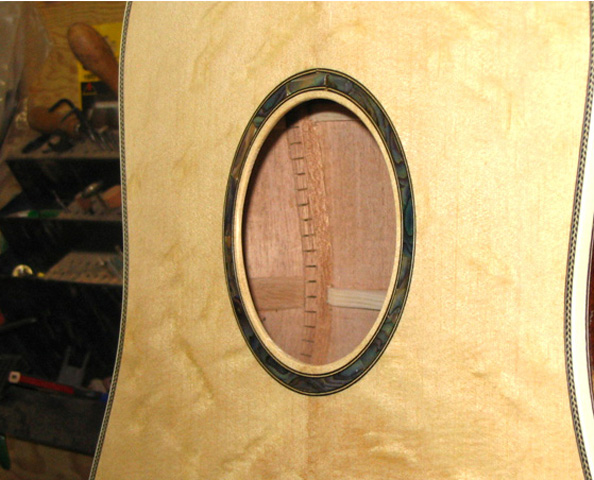

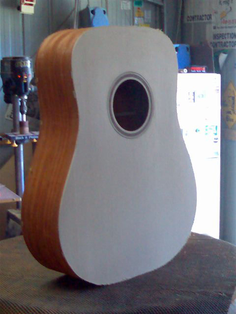

Le top avec paua rosette - bearclaw sitka
Le rosette

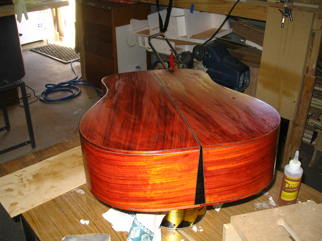

The Padauk Dread
- this one is a bit of an experiment. The top is very thin (.083") and don't even ask what the black laminations in the neck are
We strung this up before finishing it and it sounds great. Very loud with a tight bottom end and rich through the mids.(it makes my D18 sound a bit flat)
We wait with baited breath to see how it develops but it initially seems like a very nice weapon.

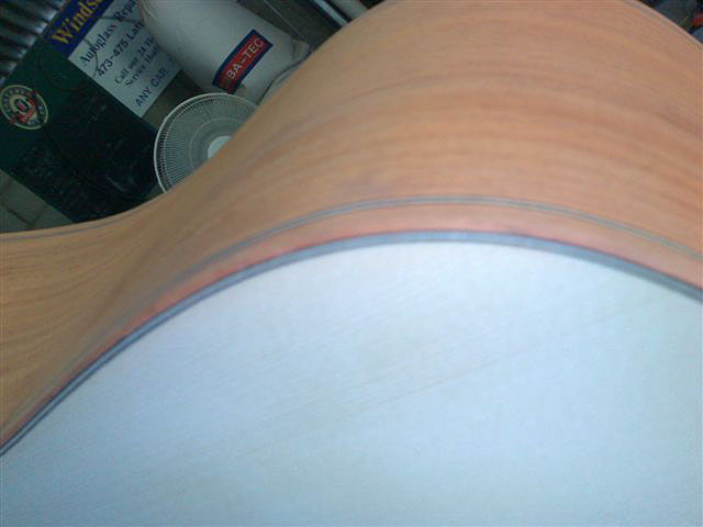

Body with Z-poxy

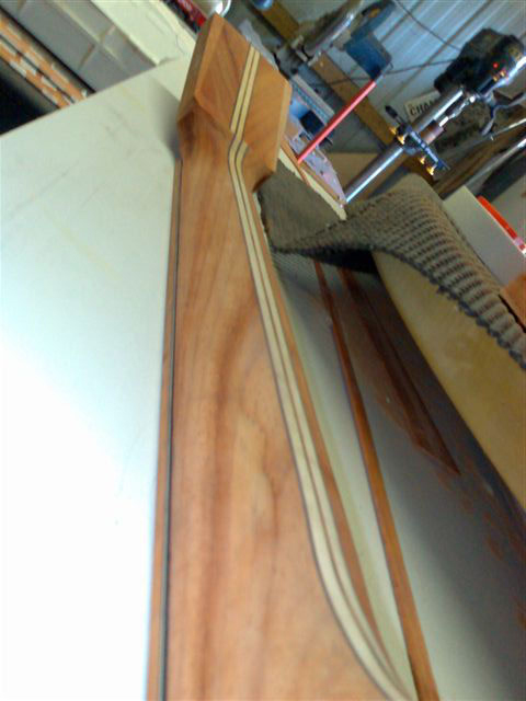

Padauk neck

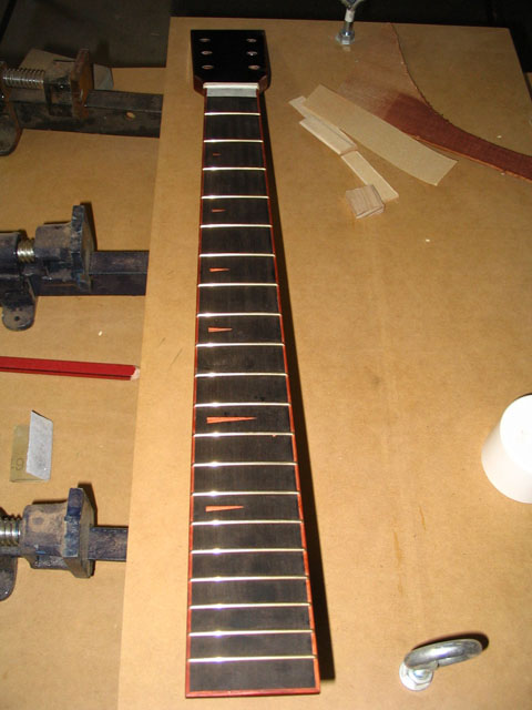

Fingerboard - with Padauk bindings and inlays of course.
You can't see it in the photo but the fretwire is that gold stuff from LMI. Looks super with the Padauk bindings.
Bindings - what else would we use - Padauk

looking REALLY good!!
LOVE that bearclaw top
PostPosted: Thu Dec 07, 2006 11:46 pm
She looks really really good Bob, very impressive stuff. The bear-claw is lovely, who was the vendor? I can't wait to see your results with Ubeauts hard shellac Paul's guitar looks soo good I am sold as well.
Where did you source the zpoxy anywhere local? Oh and PM me after Xmas when your back from the apple with your inlay material, hopefully I can dig something up that you would be willing to trade for.

How did you like bending the Padauk? I've found it challenging, to say the least.

The strip of "binding", not sure if that is the right word, on the back of the neck looks fantastic. Very creative.
PostPosted: Fri Dec 08, 2006 5:33 am
Al, that would be a laminated neck, the stips down the middle go all the way through. Looks great Eh?

Steve, we were initially concerned about bending the Padauk after reading about others experience with it, but it caused us no problems. Thinned it down to .085, ran it under the garden tap for a few minutes, wrapped it in foil and cooked it on the Fox Bender at 300. The bindings got the same treatment with no cracking

Looking good Bob. I like those fretboard markers, don't think I've seen anything like that on an acoustic. Also like the way the end graft goes through the binding to join the backstrip. Tasteful appointments.
