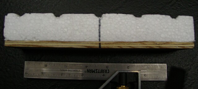

Hesh,
I got this idea from an article I read a while back by Frank Ford to use high density packing foam as a caul. Here are two photos of the bridge caul that I use for my classical guitars. The foam is high density and can be compressed about 1/4" but it still provides a distributed clamping surface and conforms to the inner surface of the top of the guitar. I use a 25 ft. radius on my tops.
The lower surface of the caul is just a piece of 1/4" plywood that the clamp jaws engage. It works great and I've not had any problems.
The foam can be carved or cut to match any bracing pattern or form and is really an ideal, versatile material for cauls in delicate areas.

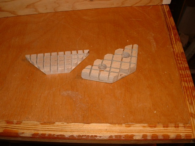

Posts: 170
Hesh
Here is what I use, Made them on the tablesaw.
Cut the gridwork while the piece is square.
Then cut the caul shape. Hope this helps.
Tom
