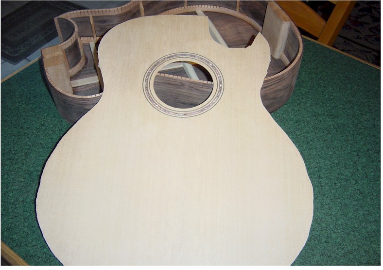

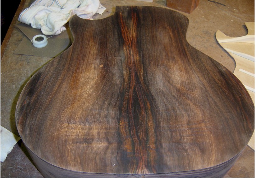

Hey folks, just thought I'd share some progress pics of#4 BRW florentine.
With the shortage of rags, I hope my neighbor doesn't recognize the BVD's from his clothsline!!

I love to back wood, Looks very nice.

Looks like a winner to me!!

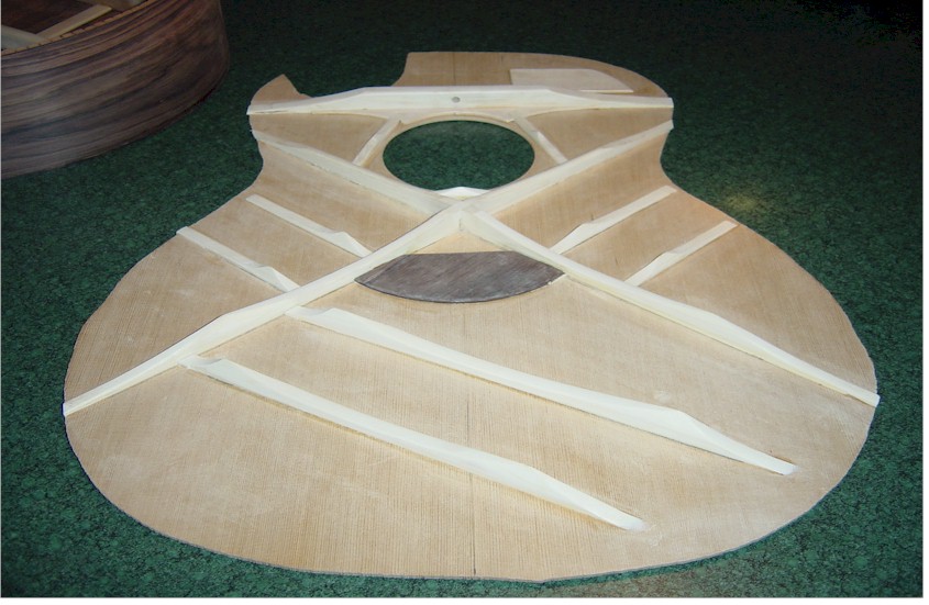

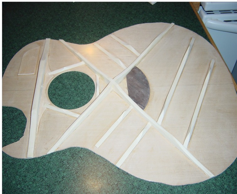

Mark that is an interesting interface splice plate joining the sound hole braces to the upper transfers brace. Can you elaborate on what drove this design?
PostPosted: Fri Dec 08, 2006 7:56 am
Posts: 147
Thanks Guys,
Michael, the soundhole baceing around the s/h, I've just played around with, and have experimented with on other guitars.The plate under the transverse brace is similar to what Bob Taylor uses. The sculptured bracing around the sound hole looks nice when the guitar is completed when looking in the s/h. I don't believe it effects the guitars nature other then looks.

Mark -- that looks great! I like the red purfling line...I gather you are going to use on your binding?

Thats purty.. golly
Unbelieveable - your really doing that wood justice, awesome job

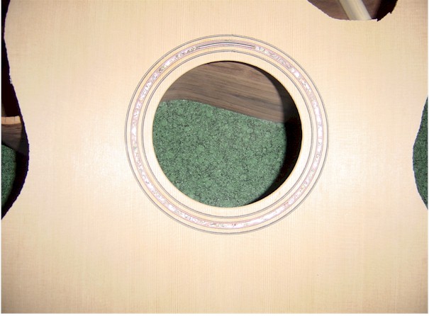

PostPosted: Fri Dec 08, 2006 10:41 am
Posts: 4820

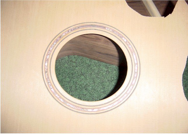

I'm in love with your rosette. Can you tell me about it and your shell
supplier?

Gorgeous guitar Mark! Love the zoot, the cutaway and the rosette... Real gorgeous stuff!!!
PostPosted: Fri Dec 08, 2006 5:27 pm
Love it Mark, this is going to be a very nice guitar and i can't wait to see her under finish!
Love that rosette very much, i'll second James to hear more about it if you will!
PostPosted: Sat Dec 09, 2006 12:42 am
Posts: 147
Thanks for all the great input guys. James, I got the "Red Heart pearl" from Joanne at Rescue pearl which is in CA. I know they have a web site, don't know it off hand, but the search eng. will come right up with it. The shell rosette is .098" and I plan on surounding the sound board and headstock with .063 in the same shell. The perfling directly surrounding the shell is a red dyed perfling which I buy in sheets from LMI. Then wht/blk. Then the outer and inner rings are pretty standard b/w/b perf.
