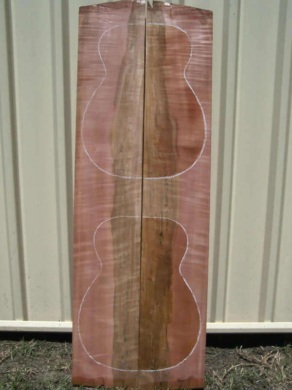

So... Here is an example of the wood I got from a mate of mine. Please excuse my poor photography. I've just put a thin coat of shellac on one of the boards inside he OM shape outline.
It was sold to him as Tassie Blackwood. The wood started out as a slab and was resawn to 12mm thick and then put through a thicknesser down to 5mm. Dimensions are 1200mm x 220mm x 5mm each. I just described in pretty vague terms what I wanted, since neither of us really know much about this sort of thing, and this was the end result.
Comments? Is it really blackwood (if you can tell from this pic)?. I haven't seen much blackwood before so I can't judge. Should I used the outside edges in the pic as the inside edge (as there's more flamey bits on that edge)?
We'll both be a bit more knowledgeable next time around, and won't waste nearly as much wood. I ended up with five boards in total. Enough for two back and side sets and some spare.
I think that it's pretty green. So I've got it stored like this in the spare bedroom, and will have for a while (unless the wife makes me move it!).

Don't you recognise this Hesh? It's tas myrtle - hold the tiger.
I've got a set of this with a nice tight fiddleback figure. Mine's all pinkish tho, none of that sapwood. My three year old daughter wants a pink guitar....
*Edit* thats Nothofagus cunninghamii for the botanically mindedPaulB39061.9968402778

My other three boards have less of the sapwood and more of the pink.
Reckon it'll work out OK?

Joel, I think you've got some nice stuff there.
I like the looks of it.

Have a look at Heshtone's latest, if yours is anything like his it will be awesome.
Good thing about this timber is the pores are so small you don't need to fill.

The spots are from a mould or fungus or something. Joels stuff is mould free, is all. Same stuff tho. Our board table here at work is the same, it's a very light brown colour.
Dunno what I'm going to tell my daughter when her pink guitar turns brown....Could always paint it I suppose.

Most Tasmanian Myrtle looks like this. The tiger Myrtle is rare because you're looking for a tree that has a fungal infection. I've seen some that looked really redish even under finish. The only thing I don't like about it is that you can't tell how it's going to look under finish. It's really hard to pick - at least for me.
Another thing I don't like about it is that I don't know how it'll sound as a guitar just yet. Waiting on Hesh, but Hesh being Hesh, I don't think we'll have to wait very long.

Yep looks like myrtle (Nothofagus cunninghamii) alright.
Tiger myrtle is extremely rare, much more so than I think most realise. It is my understanding that the Tiger figure is present only at the base, or buttress, of the very occasional tree. And that the figure cannot be determined until the tree has been feld, so this really is needle in a haystack stuff.
As mentioned by Paul, the figure is thought to be the result of a fungal invasion. A good indicator that this is probably the case, as already mentioned above, is that it's affect seems to diminish as you move further up the trunk where cooler dryer air is able to circulate. Around the stump, moisture and temperature levels are much more stable so maybe the beautiful figure is a kind of tree Tinea
