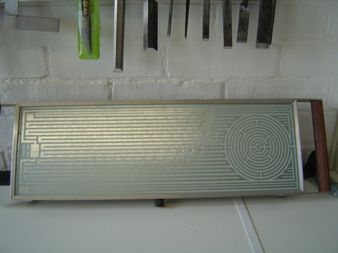

I heat my bridges, and braces, anything that is going to be joined using HHG on a food warming tray that I bought off Ebay. It sits next to the go-bar press and is thermostatically adjustable. I then use a hair dryer on the top. If the bridge position is carefully established and the outer holes drilled for pegs (I use the Stew Mac ones) the bridge can be glued in the correct position very quickly. I clean up after about 15 mins using a piece of sharpened spruce and then re-clamp.
