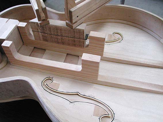

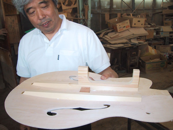

I am planning a hollow body elctric, modelled after Brian Setzer's '59 Gretch 6120. I wonder if anyone has info on these guitars; specifily the "trestle" bracing. Pictures or a drawing would be good! And does anyone know of sources for laminated plates for these?

A while back, I was looking into the same thing, and I found a couple of pics of trestle bracing...can't remember where I found them, but here you go :
You can check with Ken McKay about the pressed plates.
Hope this helps!

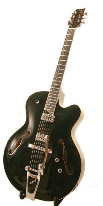

Arnt, if you are going to be playing this plugged in exclusively, it's not a bad idea. But acoustically, it KILLS the top. I talked to the guys at Gretsch when I made my first archtop (designed after a Silver Falcon) and they are now using an X brace with trestles at all four ends. Sounds like overkill to me.
When I was on my way to Montreal with this one, I stopped at Lance's and we fiddled around with it a bit. He was sitting on the floor about 24 inches from the amp which was pointed straight back at the guitar and we could not get the thing to feed back. No trestle, just a standard jazz X.

       I've not seen your Archtop before. That's MAGIC !
A very beautiful guitar.

Russ, that picture is a big help. I've only been able to peek through the f-holes at them in the guitar shops, this makes it a bit clearer.
