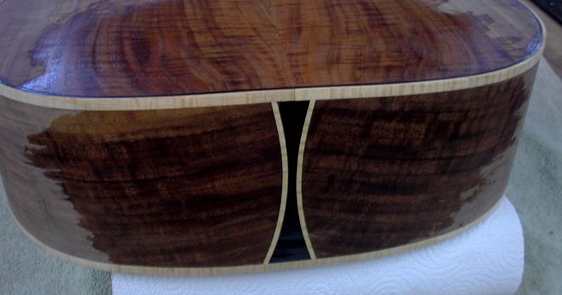

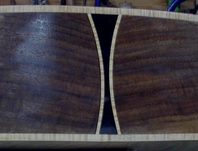

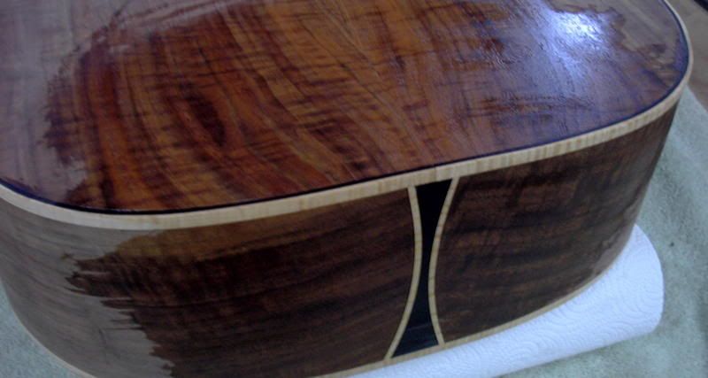

I showed a few pics of a tail-wedge a week or two ago, since then I ended up cutting out the tail wedge as it cracked when I was cutting the binding ledge. I also had the binding glued on when I notice it was cracked as well....Sooooo, I cut everything off and started over, this is what I ended up with, please let me know what you think, I will have an African Blackwood Bridge and an ebony fretboard with flamed maple binding as well.

PostPosted: Sun Dec 17, 2006 9:31 am
Posts: 954
Here is another shot that didn't show up on the first post.

PostPosted: Sun Dec 17, 2006 10:27 am
I'd say you ended up with a great-looking enhancement! It was all
intentional, too!
PostPosted: Sun Dec 17, 2006 10:30 am
Great save!! It looks like you planned it that way all along.

Very nice job!
Another 'mistake with a silver lining'! The end result is very clean and original looking.

Yeah, nice job, Greg!

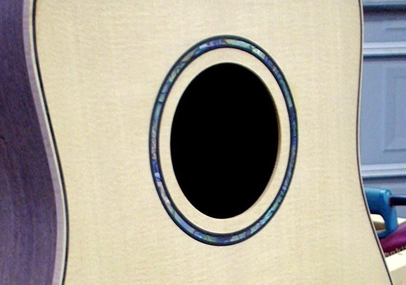

Very nice. I like the paua rosette...

Greg I like it.
You have created the "hour glass" wedge. Some one else may have seen one before but I don't recall seeing this design.
I would have never know it was a "plan B".

Very nice Greg. Where did you get the flamed maple binding. I've bought some, but the figure isn't as nice and consistent as yours.
The bookmatching on the back, and the rosette are really nice also.

PostPosted: Sun Dec 17, 2006 11:46 pm
Nice job Greg .. to me, strictly my opinion, it needs a black purf line on the sides - there is a black line everywhere else including the wedge, just a consistency of design thing I think about a lot when putting guitar aesthetics together. But then again maybe not - to each his own. Just a thought.

Tony,
I can't disagree with you, I saw that too, if I did it again I would add the black purfling on the side...oh well, I think it still works?

PostPosted: Mon Dec 18, 2006 2:44 am

PostPosted: Mon Dec 18, 2006 7:34 am
I am with Tony here. It is very nice as it is but your next shot at this end graft mitered side purfling will make that shape have a more refined appearance and it really is only about an hours or less more work. Personally I think a two or three line (w/b or bwb) will really make it pop.
The purfling line will lessen the eyes tendency to focus on the 90* change in grain orientation and the butting joint of the maple.MichaelP39069.6503819444
