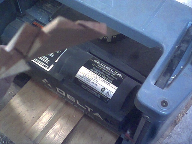

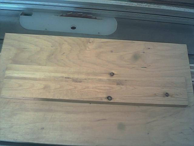

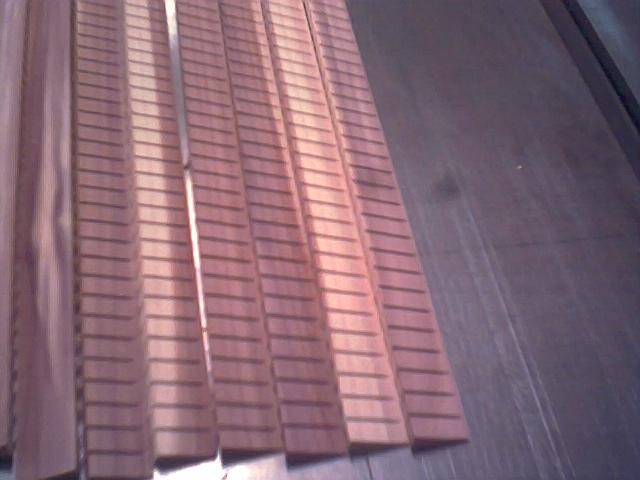

This is how I make my Triangular Linings. My photos arn't near as good as yours so please excuse.

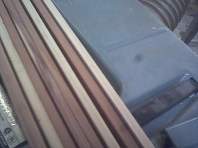

1st I thickness plane the board to 5/8" and rip it into strips on the tablesaw. I run those through the planer to end up with final deminsions of 5/8" wide X 7/32" thick

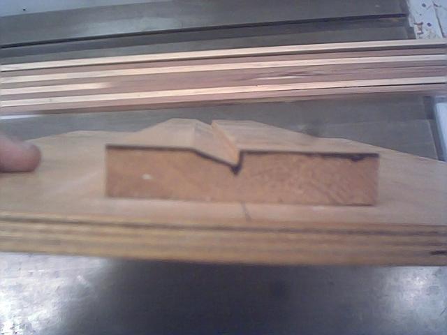

Next I place a table in the planer that has a slot cut in to accept the lining strip and hold it in the correct position.

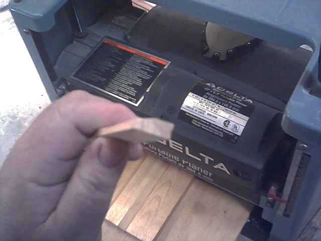

I then start running the strips through the planer to get the shape of the lining.

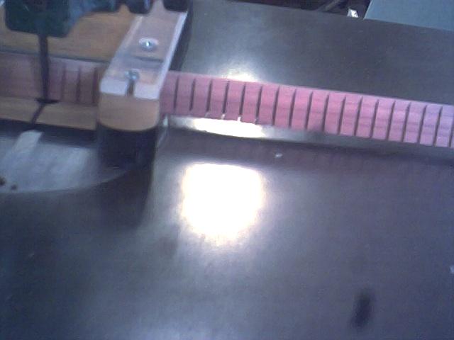

After getting the strips to this point I start runnung them through the kerfing sled.

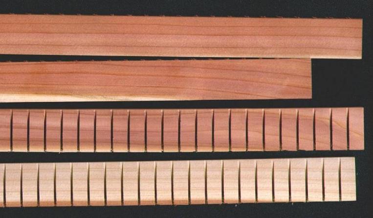

I end up with kerfed linings that are clean on the side glue surface and the showing surfaces without having to clean them up any further.
Anyhow, this is how I make them. And again, please excuse the poor quality photos.D.L.Huskey39076.0398263889
PostPosted: Mon Dec 25, 2006 4:19 pm
Posts: 244
Todd, I have some WRC linings milled but haven't used any of them yet. To me they seem a little brittle for linings. I have been using harder woods like the mahogany, walnut, and have used maple cherry and black-gum.
The wood in the photos is eastern red cedar or eastern juniper. I want to see if it will be suitable for linings.It seems to be a little stronger wood than WRC.
The blade I use for this is a 10 T.P.I. Raker tooth. I tried the Skip and Hook tooth blades but the top of the kerf looked wavey. The finer tooth blades do a much better job for this. D.L.Huskey39077.0147453704
