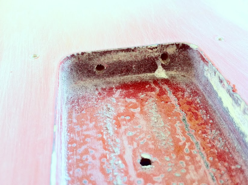

hi,
"lil bess" is a custom resto-mod project that i'm working on and while prepping the surface for paint, i noticed that the screw holes (as seen in this picture) for the "float plate" [is that the correct nomenclature?] were not aligned. will that negatively affect a.) tonality or b.) playability? also, these screw holes went clear through into the pickup/wiring cavity in the front-side of the guitar. :faints:
my question is: other than looking bad, does this affect the output tone? (i'm leaning towards drilling them out and filling them with a dowel rod and re-drilling fresh holes with a long drill bit.)

I have seen them like that before. I doubt they will have much effect on tone one way or the other. I don't even think it has any real effect on playability as far as the tremolo is concerned. As long as the cover fits I'd say it was ok.

let me ask a further question ... are float plate screw holes standard in positioning or am i going to have to wait until i buy one to know if the holes will line up?

Shad - Fender (and others) do it all the time.
Ain't no thang, man.

by the way, are floating plate screw holes standard positioning regardless of brand?

They are all copying Fender.
By the way, it's called a vibrato - not a float plate, and the screw holes are for the spring claw.

thanks and thank you so much for the correction! i really like to speak intelligently on topics when i discuss them and ironically, i did look for a schematic with the proper nomenclature, but for some reason, wasn't able to find one ... so i head to result almost to nearly saying "that silver thing"! LoL
