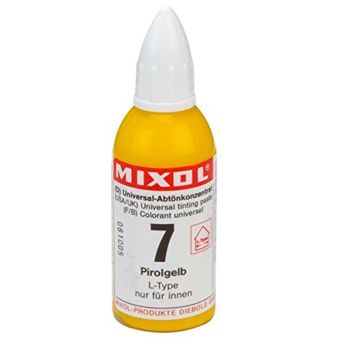

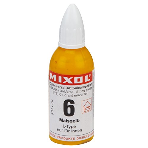

I am going to build a Stratocaster and want to do a clear stain/tint type of finish. The body wood is Mahogany and I was wondering how much the mahogany darken/change the tint?
Specifically, I am looking at a yellow tint and I was thinking of using Mixol Universal Tints, Canary Yellow, #07 assuming it affects the tone a lot. And, Mixol Universal Tints, Maize Yellow, #06 if it had just a little affect.

I don't believe mahogany would work well with a yellow tint. It's a darker wood and the yellow wouldn't really show. Seems like it would be a yellowy brown unattractive piece of wood. I could be wrong so I would encourage you to do some tests on some scrap mahogany before spraying the body. I always test spray and it's saved my butt several times.
Good luck and let us know how it goes.

While you can use Mixol for transparent effects I find them rather difficult to use for those type jobs and reserve them for more opaque uses. I typically use Solar-lux dye for truly transparent tints.

So comparing ColorTint (StewMac), SolarLux (Behlen?), and Mixol
You like the SolarLux? Why do like it compared to the others, what benefits comparatively? I am new to it all so your answer will be very beneficial.

I like Solar-lux for staining and transparent tinits because it is a single product that covers many needs of mine right out of the bottle. First is an exceptional dye stain. It light fast and very fade resistant and does not cause any adhesion issues with any finish when used as a stain like some oil stains can. Second it can be used as a universal tint for finish materials. It is compatible with both solvent and waterborne systems and adds not just dye but thinner to the finish material making creating shading toners a breeze.
I also use Mixol quite a bit too. Sometimes in conjunction with the solar-lux and sometimes on it's own. I like the mixol for creating solid colors like black, surf green etc. If used to create a transparent type shader it doesn't have the clarity of a dye like solar-lux or transtint.
