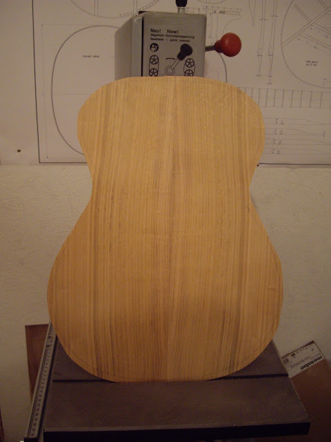

Haven't had a chance to update on progress for a while, so here goes, have managed to make reasonable progress, and so far everything is still going to plan.
Got the heal block glued on to neck blank
Reduced the back using hand planes and a scraper to final thickness or 2.5mm and roughly cut out .
Glued on the back joint reinforcement strip (Soundboard off cut) and quickly made a a radius sanding block to radius the back strip uniformly.
Glued up some of the back off cuts to use for the rosette, and then cut this out using my new shop made circle cutter, was slightly apprehensive using this at first, but worked really well. I then glued up black/pear/black purflings to the cherry wood centre ready for installing.
I then reduced the soundboard to final thickness which was so easy to do with a really sharp hand plane and scraper, so much easier than on the Cherry.
Managed to cut the rosette channels and install the rosette and plane flush.
The rosette is nearly perfect, other than one bit where its to wide, really annoying, not sure if I'm going to try and fix this or leave be.
here you can see the area that is not quite perfect!
Bending Iron finished, Im really happy with this, it heads up nice and quickly and only cost me about £30 in parts.
