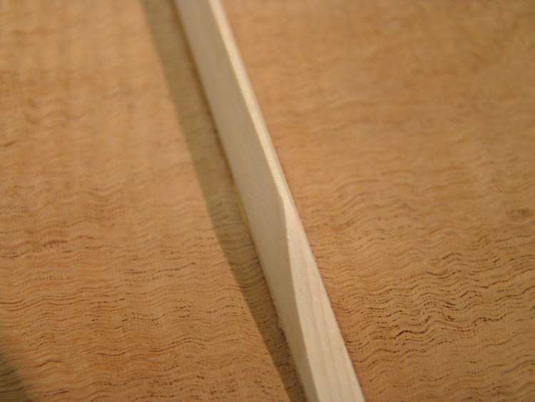

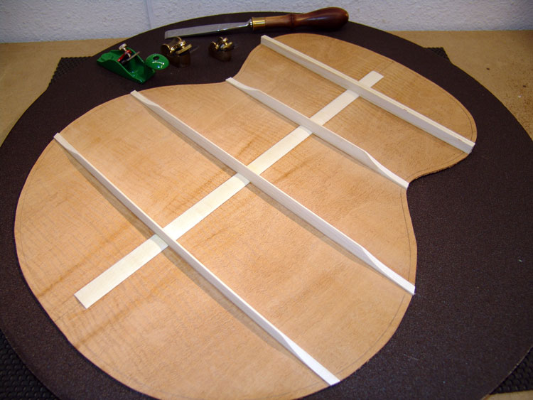

With the braces that you see below I am able to obtain the same
strength/stiffness of the wide low braces with around half the mass and
weight.
This is a back that I am working on tonight and I thought that it might
be helpful to some to see what I mean by triangular braces.  Mind you
this back has not been cleaned up yet so please forgive me for showing
a work in progress.
