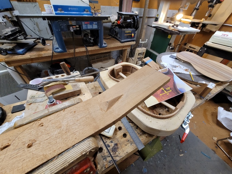

Testing out the jig on some pine it seems to work. The diamond as it turns out is not so much the hard part but getting those shoulders perfect is tricky.
These cuts look difficult to get perfect. One slip and the whole thing is off.
