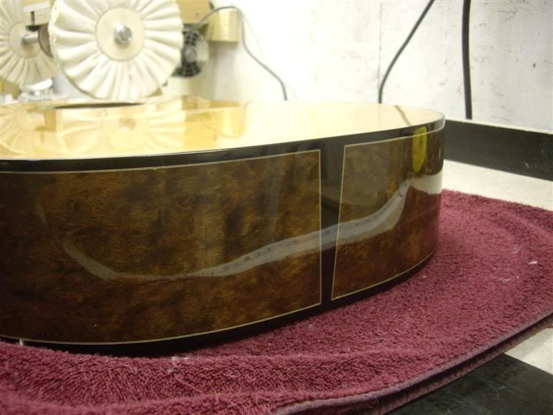

First off I want to tank everyone for their input into this thread. IMO, it's been the best if not top 5 threads EVER on leveling a finish.
I'm feeling better about my finishes after heeding some advise from you all. I'll be doing a few things different in the future, but I wanted to say thanks [:Y:]
Here's the results of my efforts over the past few days.
And she'll be singing tomorrow :)
Thanks again!
