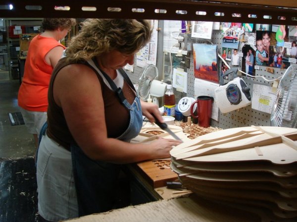

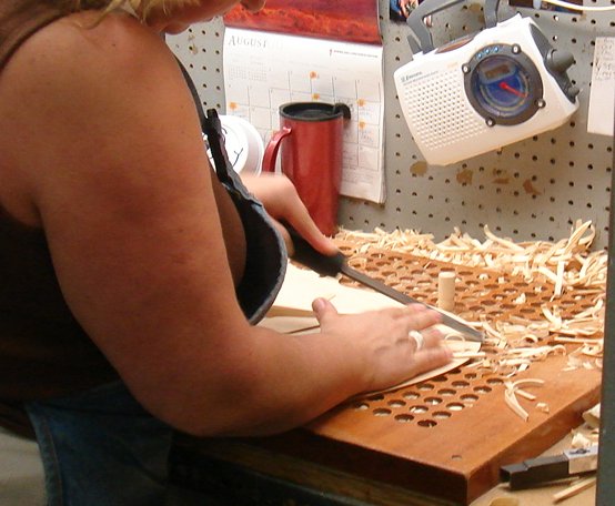

As a matter of interest, at the Martin factory I was surprised to see it being done by hand with simply a chisel. (Including the scalloped braces). She was fast and incredibly neat! As you can see, they are not all tiny whispers of shavings either.

Rod buddy fascinating pictures from the Martin factory! [:Y:]
