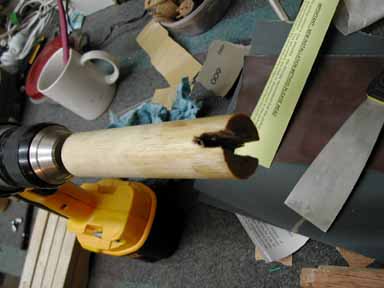

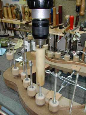

I am working on gluing a back on an archtop electric I am working
on and I came up with a nifty little device for tightening up all those
spool clamps around my mold.
It's a 1" piece of hardwood dowel with a 1/4" hole bored straight
through the center. The business end is slotted and relieved slightly
to grip those wing nuts. I CA'd in a bit of 1/4" drill rod into the
other end to chuck it up in my hand drill. I also dowsed the
business end with thin CA just for good measure.
She works great!! The drill is spinning in the second shot.
Cheers!!
Louis
- Louis Freilicher

Nice idea. Looks like you could set the torque control on your drill to set
clamping pressure too. I've always used my air gun - it's silly fast, but you
have to keep good aim and doesn't work well if the thread aren't clean.
