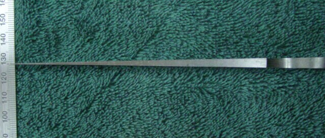

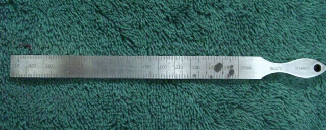

I thought I would share one of my handier tools that I use extensively when setting up string height at the nut and string action at the 12th fret. Many of you may already have one.
It's a Starrett #270 Taper Gauge and is graduated from 0 - 4 mm on one side and 0 - .150" on the other. It has saved me a lot of time in shuffling through my feeler gauges. Now I can get a reading of height anywhere on the fretboard in much less time.
I'm sure that there are many other uses for it that I just haven't thought of as yet...
Great for gauging gaps for shims too.
