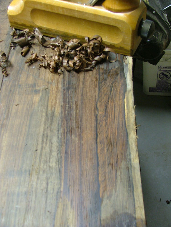

PostPosted: Sun Jan 07, 2007 9:16 am
I've emailed this vendor a couple times asking for
Cites certification information, and they ignore my emails.
To me that speaks volumes.
From my understanding, Allied has paperwork for what they sold, as does Steve at Colonial Tonewoods.
I have some BRW I bought from someone who had some pieces in there garage for several decades, but as there is no clear way to get paperwork for it, I choose not to sell it.
Besides, I want it for myself.
If you're going to look for BRW, look for this kind of stuff:
Mmmmmmmm.......Chocolate!
Don Williams39089.7277430556
