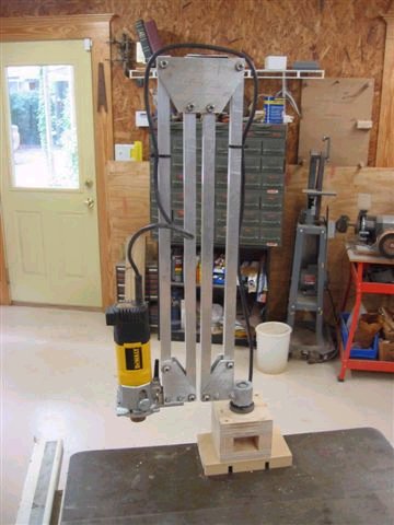

I built a jig like Arnt's (which is really impressive!), but the old saying about
fool-proof" was coined for guys like me. I found a way to screw up the operation of that jig. It is inherently top-heavy, and I was able once (or twice) to let the bearings slip away from the side...the router tipped in, and made a deeper cut than wanted.
I then made a jig like the one I hope to picture here.
It came from LINT and enjoyed several incarnations. Hope this makes sense:
The design is borrowed from those armed lamps that move about on the workbench, while holding the lamp in the same plane. This jig just holds a router.

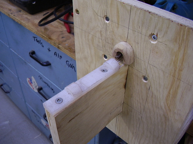

Posts: 639
This won't surprise anyone, BUT-after building Don's jig,I wasn't sure what to do about the donut to ride the rim. Craig directed me to the UHMW flanged bearing at McMaster-Carr or MSC with part number. I have a PC 310 and had made a Lucite sub-base for it for use on the jig. I used a Forstner bit to do the counter bore, dropped it in(lam trimmer body holds it in) cut off the surplus length so that it projects below the bottom of the base about 3/16, and -Bingo, ready to go. That is just one of the fine things about this forum- the suppliers will give you the info,even when you are building something they sell. Thanks.MT
