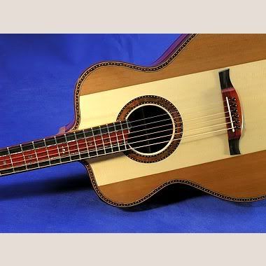

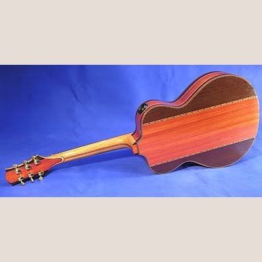

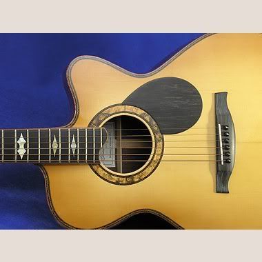

Im curious as to whether someone has posted a photo essay on how to create shoulders like these
{I dont know exactly what they are called and would be grateful if someone could clear that up for me, if there is a correct terminology}
Ive used Howard Klepppers guitars as an example, because they are gorgeous pieces of art, and its nice to use any excuse to look at them. But Im extremely keen to know exactly how this is done...
{I have an idea but Id like to see the process outlined by someone who knows}
I looked through the archives but couldnt find anything, but that may be because I dont know exactly what to look for.
If someone has an explanation and/or some photos of the process of building shoulders of this type,
Id be extremely pleased if they could lay some info on me.

Sorry, I never looked in at this thread until Charlie emailed me today. I thought someone was posting a photo-essay about how he makes slope shouldered dreads or something like that.
Not a lot to say, really, and I don't have process photos. Speaking of process, someone mentioned that there are standard methods that get documented here. To me this is the wrong way to think about lutherie, unless your goal is to reproduce not only the instruments that have been made before, but also the methods. That way of thinking stifles innovation. I know that Tony K approaches the work the way I do: I think of something that seems as if it ought to work, and then I try it. If I can find out how someone else did it, I look at that, but I don't necessarily repeat the method. There are no "standard' methods, really. Just ways that have worked for someone. I understand that a lot of people want to work from plans and find out what the popular methods are. It's simpler and safer that way. But if you want to start thinking about creative building, then I think it's time to stop thinking that there are standard ways to do things, and start trusting your own sense of how it works.
Anyway, I call these recurved sides. I saw the Interdonati long before I did them, so it probably influenced me, but I wasn't actually thinking of it at the time. I was thinking of the members of the viol family, that have their sides recurved like this. They were commonplace in the Renaissance, but got pushed aside as the members of the violin family became the standard. The bass viol survives, though. Part of my thinking was about ways to strengthen and rigidify the upper bout, so as to delay or prevent the need for neck resets.
I bend the recurves by hand on a pipe style bender, after doing the sides in a Fox bender. But they could be done more easily and more uniformly with a Fox style cutaway bender. I've just never bothered setting one up. It's a tight curve and hard to bend. Any guitar I do like this has double sides, which makes the bending easier, since each side is only about 1/16". I laminate with clamps and cauls around a form of stacked plywood. That forces the curve into its final shape if the bend wasn't quite right. I use a more-or-less circular curve in the recurve, and an oscillating spindle sander to do the shape in the head block after I rough bandsaw it. I clamp the sides (already laminated) to the block with a one piece caul for both shoulders, and glue with epoxy. The caul needs to be a good fit. I bandsaw, rasp, and file it. Very low tech.
