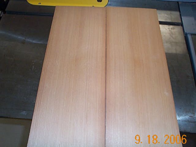

Serge, here's a pic of the Tamarak top I have. It was sent to me by another Canadian whose name I can't recall. I ordered some sitka tops and he threw this one in for free. Can't beat a deal like that!
This top is very stiff, looks kinda like WRC and when tapped it rings like a bell. Just wish I could remember where the heck I got it.
PostPosted: Sun Sep 17, 2006 8:48 am
Thanks a lot Dave, WOW, it sure looks nice from here, tight grained and all, it sure will make a fine looking top.
I'll really try to get my paws on some if i find sufficient diameters!
PostPosted: Sun Sep 17, 2006 8:52 am
You're welcome buddy! Let me know if you find some, I might like to have a few more sets in case I do something stupid when I'm ready to use this one.
PostPosted: Sun Sep 17, 2006 9:12 am
You never know Dave, you just never know, i'll keep this thought at the back of my head!
