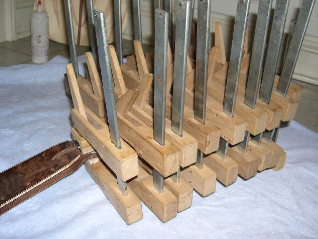

[QUOTE=Steve Kinnaird] Hesh, that will certainly work.
But here's a pic of how I do mine:
You might just be able to see the caul under all those clamps. It has arched "feet", or runners that bear on the edges of the board.
That's 100% exactly the same way I do mine. Down to the clamps used.
