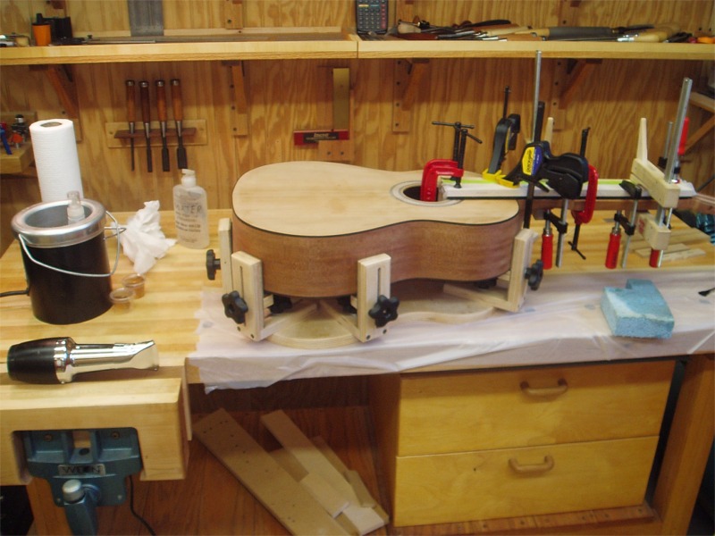

Hesh, that will certainly work.
But here's a pic of how I do mine:
You might just be able to see the caul under all those clamps. It has arched "feet", or runners that bear on the edges of the board.
Steve Kinnaird39043.4256365741

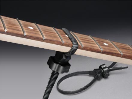

I use these clamps. 6 of them and a cam clamp at the heel.
By the way you can get them cheaper at Walmart than at StewMac or LMI. Look for them in RV section of Automotive department
PostPosted: Wed Nov 22, 2006 2:50 am
Hesh I used to do it just like you, using neoprene surgical tubing to wrap it with. We always used this method when bedding a rifle action, and I just transferrred it to the guitar. The last one I did though I used the Stew Mac clamps,and I must say that they made the glue clearup much easier and they worked really well at centreing the board if you don't use cut off staples. I also use a full length caul slightly narrower than the fingerboard to even out the pressure.

I use my Stew-Mac FB radius sanding caul and three or four clamps. VERY easy.
