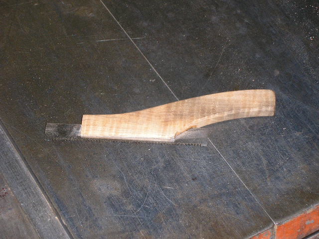

PostPosted: Sun Jan 07, 2007 5:36 pm
For the first 4 guitars, I used a little saw I made from a Stanley flush trim saw I bought at HD for $15.
I now have a blade from Shane at Highmountain for the table saw.
Here's the homemade hand saw.

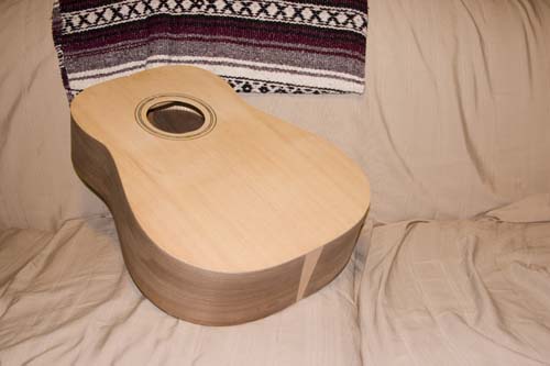

PostPosted: Mon Jan 08, 2007 2:05 am
Posts: 761
First name: Blain
City: Leander
State: Texas
Thanks, I've taken plenty of pictures along the way.
Here's one that is "pre-binding". I have since installed maple binding, but unfortunately I don't have pictures with me. (I can get some put on when I get home).
Also sorry for the poor quality of the image. I have re-sized it a lot for sending through email so the size is a lot smaller than normal.
Y'all are great! Thanks again for all the help.
