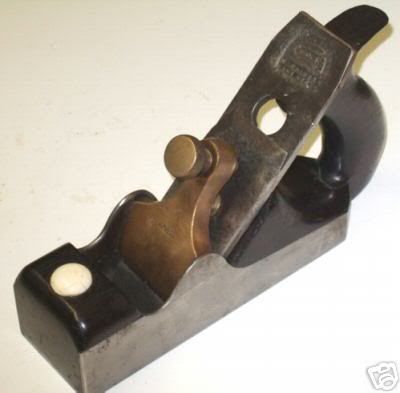

Starting to research the tried and true planes of yesteryear, I discovered England's Norris planes {The Handplane Book} , which pricewise are untouchable for someone like me , and the reproductions are insanely priced too!
Unfortunately I knew I had to have some.

Wow charliewood, you ARE crazy! Just kidding, but I would really love to see what you come up with, not to mention pictures of the process of making metal planes.
The original Norris planes in nice condition are priced very high compared to the similar Brithish infill planes. You can get a good Spiers, Mathieson or Preston for a lot less than the equivalent Norris, and they are supposed to be just as good as the Norris planes who I understand won much of their popularity due to the adjuster feature. I don't have any experience with either brand (nor infill planes in general for that matter), but I've been curious about them for a long time. I just won this plane on ebay, we'll how it works out:

Thanks for the info on other brands of infill planes Arnt! I think they may be more available in Europe Im afraid - I certainly dont see many on Ebay in North America.
