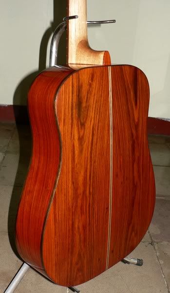

I spent a lot of time around cocobolo dust in Nicaragua and eventually realized that the nagging sore throat I had was due to it. Luckily it never got worse than a sore throat and some sneezing, but I don't know what would happen if I spent significantly more time with the wood. A shame because it's absolutely beautiful.
Here's the first of my Zepeda guitars:
Andrew
