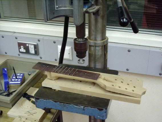

for my mandonaught I tried a new technique.
I put a slight bend on the frets by putting them in a 5mm hole drilled in a block of waste wood and .....
well.....
bending it!!!!
once that was done I used a T-bolt used to hold a vise onto the table of a vertical mill as a press in the pillar drill.
you can see the block with holes bottom left of the pic, with a few frets.......
I'm never gonna hammer frets again!!!martinedwards38891.5695833333
