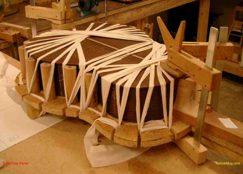

I use the roping method and dont have too many problems. I use 2" wide
bias binding tape bought from my local sewing shop or macrame rope
bought from same shop.
The important thing is to do a dry run and make sure everything is laid
out ready. Nothing worse than ending up a rats nest because you
remembered something at the last minute. Also, looking from above the
rope should have a radial pattern centred on each bout when youve
finished roping up. See attached pic of a back rope up on a classical.

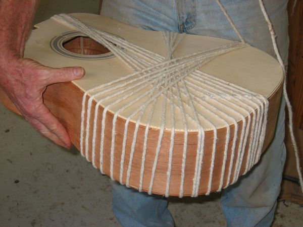

I really like the way Martin has the jig laid out for the roping method...that's cool. But given a few dry runs (and you practice with any old yardsale type guitar) and it becomes more do-able. I didn't use the rope method for the back and top (used a workboard instead, which I thought was great). We did use the rope method however as a supplement for the binding/purfling. Here's a shot of the example I took so I could remember how to do it. It's using a very long roll of "thick cotton mop string". There is no doubt it works GREAT once you get the process down.

You know what, come to think of it, I have an easy idea that would work in conjunction with the rope method if that's the direction you'd rather go. If you're interested, PM me with your email address and I'll take a few photos sometime this morning that might help.
