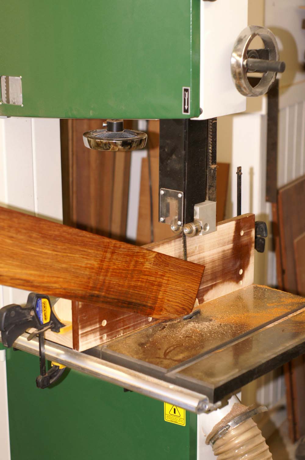

For years I have have resawn my own billets, both softwoods and hardwoods (including Ziricote, ebony, shedua, koa, walnut, and hard maples) up to 11 inches wide. I've wasted a piece of wood or two and dulled a few blades but I have never experienced what happened to me last night.
I was resawing some qtrd cocobolo from a billet with a spanking brand new Lenox tri-master blade. I had made one full pass and was in about 1 inch of cut on my second cut when it something happened but I still can't figure out what it was. The picture below shows the ruined results of sides I was cutting but the result to me was a quick trip to the emergency room.If you closely you will see the end of the wood was forced down and through the table insert.
I have lacerations on my right middle and ring finger and a broken bone in my ring finger.The blade itself never touched me, thankfully.
I always make sure the wood is square to the saw table and that I keep the wood firmly against the rip fence.This is about as close to a bandsaw kick-back as I can imagine.
Has anyone else encountered anything like this and what should I look out for in the future? I can tell you that I will be a bit nervous from here on in while resawing.

The bandsaw blade definitely has enough power to grab the end of the wood and jerk it downward if the end is not fully supported by the throat plate. I would guess that either (1) the throat plate is broken, or (2) the wood you are resawing is thinner than the opening in the throat plate.

Was the plate aluminum? That just doesn't look right! I'd be asking too!
   I could imagine if the back of the work was lifted, inadvertantly it might grab, but that seems like a real stretch!
   Sorry to hear about your injuries, and thanks for posting because I'm going to take resawing a lot more seriously!
PostPosted: Sat Sep 30, 2006 11:35 pm
the plate definitely let the wood jump here .. my delta does that sometimes as well, but the conditions ahve ot be jsut right - the wood needs to be able to fit into the slot, and maybe the feed rate is a touch to fast. maybe because its only a 3/4 hp it cant rip the wood right up out of my hands, it just jumps, and its always at the start of a cut - once the wood gets to the table past the blade, its fine. The slot in the plate is too big, giving the blade somewhere to push the wood into. replace it.

Thanks to all for the well wishes and advice. I think this was a case of the "perfect storm" that was brewing.
1. Lenox Trimaster blade on less than seasoned cocobolo. When cutting the billet just before the accident the blade would occasionally grab or chop the wood. Searching the forum archives I see where other have run into this problem with this particular blade.
2. The throat plate that came equipped on the Rikon bandsaw is unsubstantial, being made out od a soft plastic. When the blade "chopped" at the start of a new cut it forced the wood (this piece being 5/16" thick)down through the throat plate.
Lessons learned:
1. Get rid of the Tri Matser blade and go back to my proven WoodSlicers.
2. Replace the throat plate with either phenolic or aluminum.
3. Use a more sunstantial clamping method on my rip fence.
4. Show more respect to the machine in use.
I hope to be back in action in about three weeks to finish two builds in process and start another.
with much more respect for a bandsaw,
Tom

Tom all good ideas you have. You may want to try the Lenox Aluminum Master Blade. Differant band and gring on the teeth. Don W., Larry Davis and I have been using them. So far they are pretty good. I just cut some cocobolo and it went pretty smooth. Get well soon.
Oh one more thing: How wide is that blade. Looks like 1/2" in the pic. I had the most problems with the 1/2" TriMaster. Scare/d the daylights out of me. May I suggest a 3/4" to 1" bladeBobc38991.4237268519
