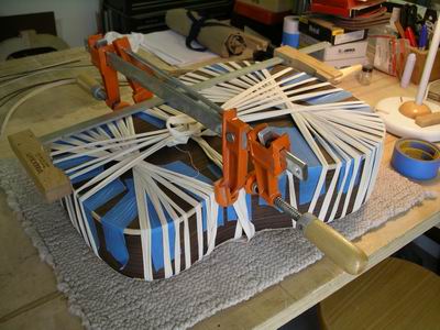

I am having pretty good luck with the method Robbie shows in his dvd:
The blue tape just holds things in place. Cotton binding tape provides the pressure to pull the wood binding into the body. I add a few clamps in problem areas.
Look at the gaps critically. If they are too noticable, they will probably make you hate to even look at the guitar. It might be best to route them off and start over again.
