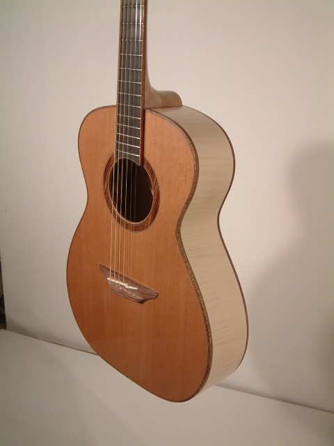

I don't do a full cantilever, but very much believe in freeing up the upper bout of the soundbaord via an extended neck supporting a free floating fingerboard over the body and adjustable neck joint. I have documented my reasoning and how I build this on my website here.

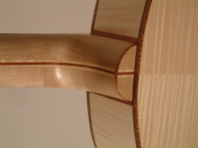

Peter,
i'm not quite sure what you mean, but here are some of the guitar around the neck area - is that what you meant?:

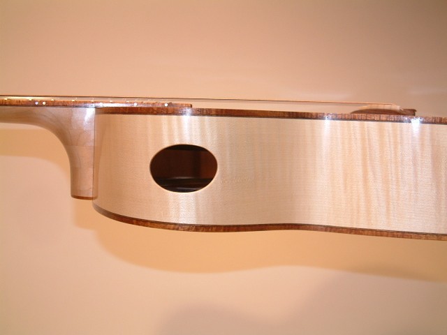

Right now I'm not interested in trying this design, but I have a couple of questions for you, Dave.
How wide is the gap between the FB extension and the guitar top?
Does the top ever vibrate enough up there to get a buzz by touching the FB?
PostPosted: Sun Oct 15, 2006 8:19 pm
[QUOTE=old man] Right now I'm not interested in trying this design, but I have a couple of questions for you, Dave.
Ron[/QUOTE]
Ron,
It depends on the action it is set up for. I have it set up for me with 4-5/64" on the high E and 6-7/64" on the low E and the widest gap is around 0.008". Here's the best pic I could do:
[QUOTE=old man]
Ron[/QUOTE]

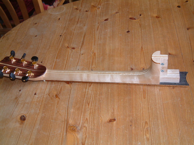

No. The fingerboard extension is glued to a 20mm thick part of the neck extension that covers all apart from two small strips at the edges. The aim is to keep the fingerboard as rigid as possible all the way up the neck to give the fretted notes as even a sustain as possible:

Dave, that guitar, Russells' little London Plane one, Steve Ks Ambrosia, and anything by Joshua French are among the guitars I truly, truly covet.
My neck extension is only 12mm thick and a little wider than yours as I also run my CF rods the full length of it, like you I have abandoned bolting the extension down and yes, no buzzes. I don't use a M&T either just a butt joint
Colin S39006.302662037
