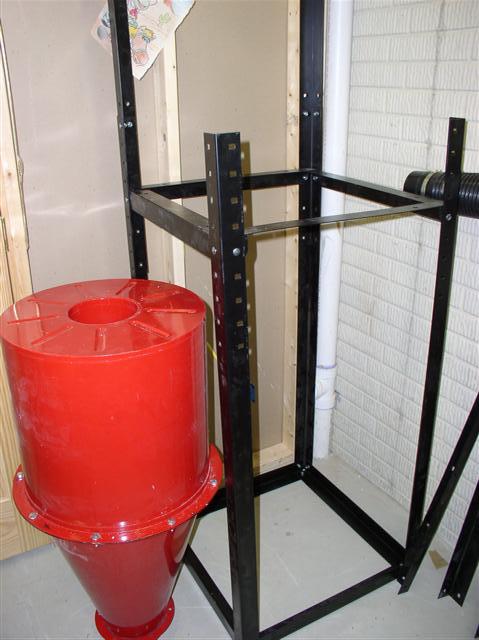

Ok guys here are twp pictures,
You can see I have to add a brace at an angle to make the drum rest in the frame.
I hope im just doing something wrong. Im flying with out instructions.

Lance, if I understand your problem correctly, it sounds like you need to cut a plywood brace, if you will. A square large enough to sit on the frame with a hole with angled sides to hold the drum.

Hmmmm. Looks like the wrong size frame to me.
I would just add a couple of pieces like you're using to hold it for the photo since it doesn't have anything to do with the operation of the unit. Or you could take an inch off each of the cross members, unless that will interfere with the rest of the unit.   Or you could bolt some extensions onto flange on all four sides so it will sit on the cross members. That sounds good to me, but I don't demand the highest level of perfection (yet) like you do.

Looks like it needs to be supported on the flange. If that's the case then the base needs to be a smaller square. Is it possible to shorten up the base pieces? Will the can fit underneath properly then? If not then you need a smaller can or longer vertical angle pieces.
Looks like they may have sent the wrong sized stand?

I like Lillian's idea!! Very easy and reversible.

I too like Lillians solution. Simple and effective.

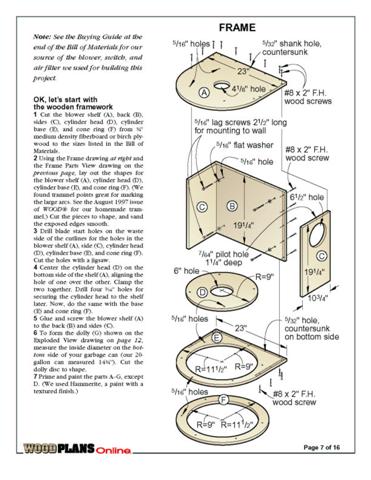

Any chance you can take the frame back and just make your own support frame, wall mounted like this or some other wall mount system made from plywood?
Just another suggestion. Have fun.Rod True39032.7605439815

I'll run out and measure the plywood platform that goes in there...I didn't send it to Bob to save him $$...he said he had plywood there so to leave it out...be right back!

Okay, I'm back!!
The plywood where the cyclone sits is 24 1/4 by 23 1/2 (this is the piece with the hole cut in it)...also, the back piece that the top of the cyclone screws to is 24 wide by 36 high...
Hope this helps...this dust collector just won't go away!
Larry
PostPosted: Sat Nov 11, 2006 2:59 pm
AH HA! A plywood platform!
Ok, so there a wood collar that the cone drops into,
Cool, ill get that made and ill be in business!
Thanks Larry!LanceK39032.9590277778
