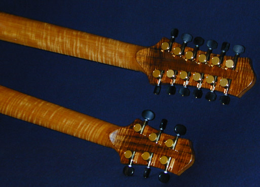

curly mahog, curly koa, double neck 6/12 .. doesnt get much sweeter.

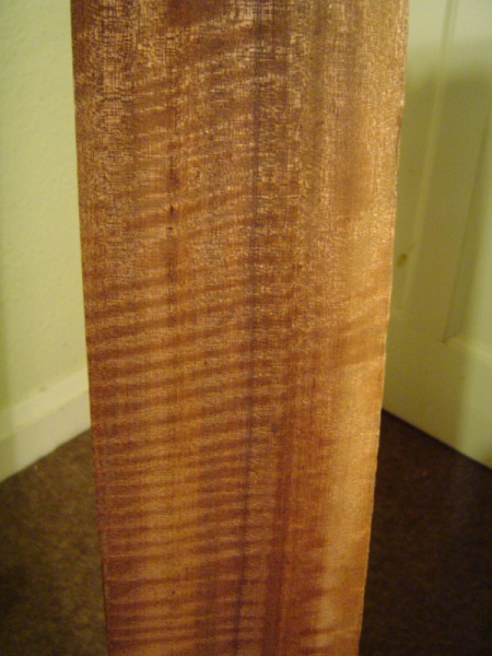

I use figured mahogany for necks. I managed to get quite a bit of neck stock (6 pieces), like this one. They come from the same boards that my collection of figured Honduran back & sides come from. Each billet is 120cm x 12cm x 3.5cm so the stock is thick enough for V-joints. (If I mess up bending the sides I can re-saw the neck wood!)

Beautiful!! Can quartersawn billets be found or does quartersawing diminish the amount and depth of figure; if not quartersawn, would neck have to be re-inforced-SS
PostPosted: Sat Nov 25, 2006 7:12 am
At no point are those billets more than 2 or 3 degrees off quarter, and as stable as they come.
