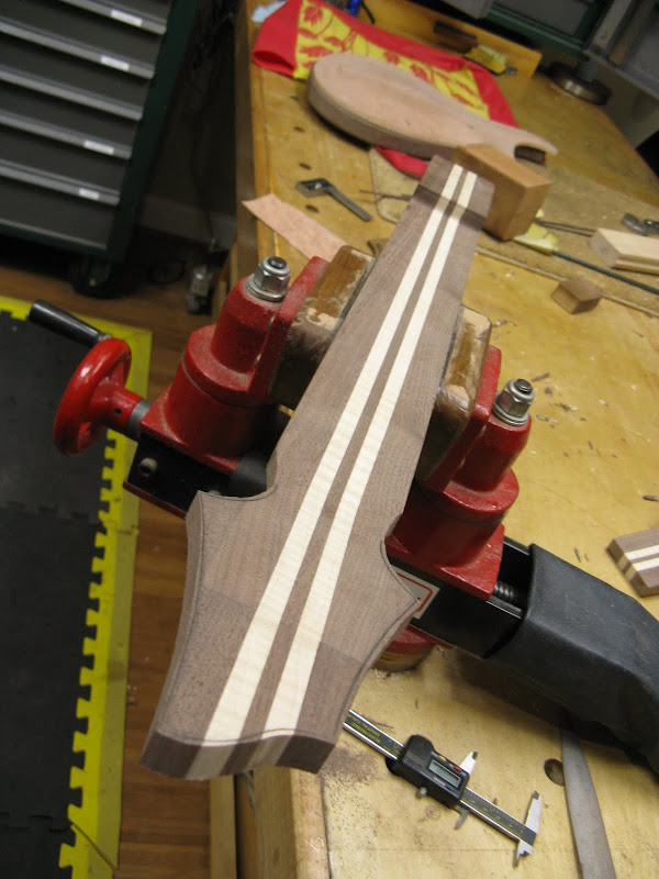

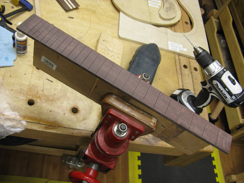

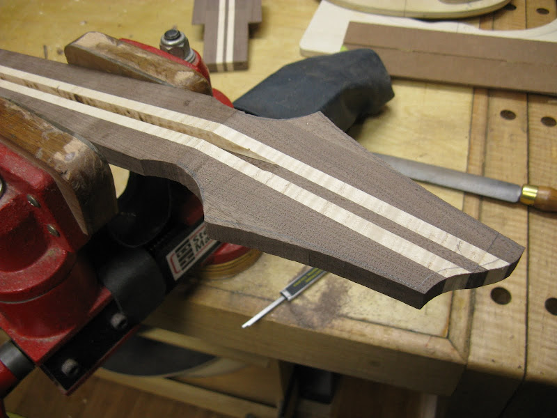

Filippo Morelli wrote:
Okay for you photo junkies ...
Headplate thicknesses with Saf-t-Planer and cut on bandsaw to get in the zip code.
Difficult to see in this photo, but the neck is cut to a rough profile. This guitar gets a backstrap, which requires getting final thickness of the neck behind the first fret dialed in. This is because the backstrap is veneer and won't take much sanding to go through.
Faux bound fingerboard on this one. This is a jig I built to cut the correct edge angle on a fretboard. The fretboard is a pretty rare Curly Katalox, from Mexico. This photo shows the correct color, a dark purple.
The faux binding is 0.050" cutoffs from the fretboard blank prior to slotting, which are then glued back on with CA. Makes for a clean edge. Also allows for fretting after finish.
Finally a bit of West Systems epoxy glues up the fretboard. I use a technique I learned from Todd to locate the fretboard. I am NOT a fan of pins in the fret slot holes. Instead I take some scrap Mahogany blocks and CA them to the neck, butting the blocks to the fretboard. The fretboard can then be removed then wedged back into place. Under glue up it will not move. When finished, simple tap the blocks with a chisel and they pop off. The remaining neck area where the glue up was done gets routed off anyway.
Hope this is helpful. If anyone has questions or observations, please feel free to chime in.
Filippo
I usually do the pins through the fret slots, but I read this a couple of nights ago and decided to try it today. Great technique. I think I'll glue all my fingerboard on like this from now on.
