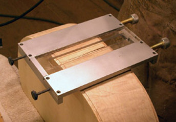

I do it after assembly with a 3/4 router bit and a jig

I do mine after the box is together and the binding is on.
I use my endgraft/edge vice from Chris at Luthiers tools
I have 2 templates for this vice. One for my endgraft and one for the neck mortice.

After assembly, using a router with a spiral cutting bit and Robbie O'Briens mortise cutting jig. I've used it on both cutaways and non-cutaways and it works great.
My barrel nuts and bolt holes are all done just using a small ruler, no dowell line-ups.
