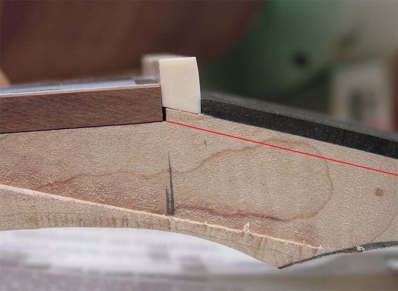

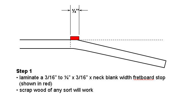

This is how the fingerboard stop works. It effectively lowers the fingerboard in relation to the face of the headstock, allowing the headstock binding to be the same height as the fingerboard binding, which in turn allows the side purflings to meet up.

Posts: 2692
Get a look at Benedetto. As far as I know that is the only book which even mentions the problem, which is to get enough room for the side purflings to continue under the nut (where the bindings will stop for a break. Benedetto, however is not very clear in his description or drawings. The stop is glued to the plane of the neck that the board will be on, and its effect is to extend the plane of the headstock over that part of the board, thus setting the nut (which will rest on the stop) a little lower into the headstock face. The nut will have the headstock angle cut on its bottom. So initially, before installing the stop, the plane that the board will be on should go at least 3/16" beyond the end of the board; 1/4" is better. When you are all done, looking from the side, the plane of the neck under the board will appear to end at the end of the board.
A thicker headstock veneer will also give you more room for your binding and side purfling.
When you look at Benedetto, the above will, I hope, make sense.
And bind your headstock before you glue the fingerboard on. Don't ask my why I know this.
[edit] uh-oh. What John does is the opposite of what I do, and why I found Benedetto misleading. But I have to run now, I'll check in later.Howard Klepper39092.6004398148

Very cool pic, John. Unfortunately for me, it'll have to wait for my next effort since the plane of my neck is already established... truss rod slot in and CF rods glued in place.
Since you're the neck guru, do you have any finished pics showing the effect in all it's glory?

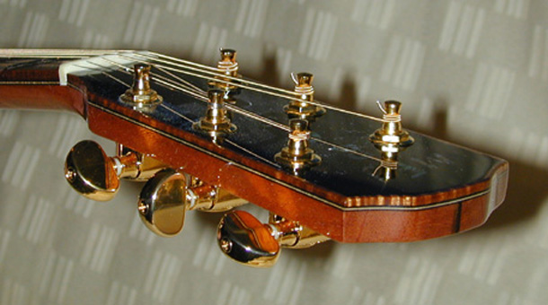

I personally like the binding and side purf to both stop, and be divided by the nut ... way easier IMO, and most factory guitars (non archies) I believe are done this way if they are doing it. It looks like this at the nut.. so what we did here was to bind the fretboard with a binding purf combo, then on the headstock, in order to not have to worry about the purf at all, was to laminate it full headstock size under the headplate - so black/maple/ebony headplate on top of the neck blank in the headstock area. Then all you have to do is route away the ebony edge (we left some so it looks like its blk/maple/blk purf) and bind it in koa - no worry about purfling delamination, or mitering the purf - its perfect, and jointless, because its a full sheet.

PostPosted: Wed Jan 10, 2007 11:24 am
Nice Tony...that's definitely KISS at it's finest.
That's a great look! Thanks for posting...lot's of ideas surfacing!
PostPosted: Wed Jan 10, 2007 11:25 am
That looks great Tony! And the finish is so shiney I thought I was looking at a 7-string for a minute there.
PostPosted: Wed Jan 10, 2007 11:27 am
A student and I did that one together last year .. it was a first for both of us !!! He will be back starting next week for another ... and wanting to bind the darn headstock again !!!

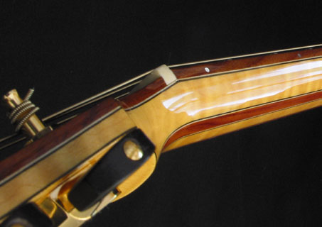

JJ, I think I'm a ways off from "guru", but here's that same guitar finished.

PostPosted: Wed Jan 10, 2007 12:20 pm
John...That's what I'm talking about! Absolutely gorgeous.
You're too modest...I've never seen anybody who makes complex necks better...or even attempts such complexity! Very inspiring

First off, my earlier post should have said the stop raises the nut in relation to the headstock face, not lowers it.
As far as John's first photo goes, I now see what the issue was. I saw the ebony headstock veneer as the board and the bound fingerboard as the headstock. The scarfed headstock threw me so I reversed the two in my quick look at it. We do the same thing, after all.

If you do it as in John How's photo (nice looking git, John), you will not get a continuous line of side purfling, because of the lap over of the board purfling with the headstock purfling. Avoiding that is the point of the fingerboard stop.
JJ, I always do (2) before (1), above. When you use the stop, you will initially layout the point where the headstock plane begins as if the nut is going to rest on the fingerboard plane. After the stop is installed, the nut will be on the headstock plane, which is extended over the stop.

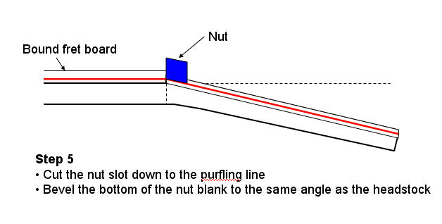

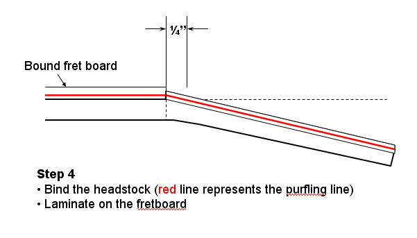

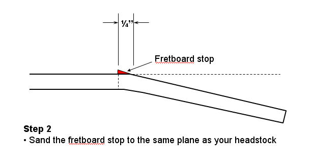

Thanks, Howard...I realize the difference now with your explanation and after "Archtop Anthony" Z. emailed me a Powerpoint series of sketches describing the stop procedure. Now I believe I understand how to pull it off as well as to better execute the standard method from John and Tony's post.

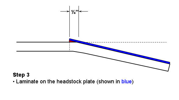

PostPosted: Fri Jan 12, 2007 10:58 pm
Here are the steps JJ was referring to in the email sent that will result in a nut installment as shown in John Watkin's second posted picture.

PostPosted: Sat Jan 13, 2007 2:16 am
That was a tremendous help, Anthony...thanks. It's now in my reference book for the next opportunity.
