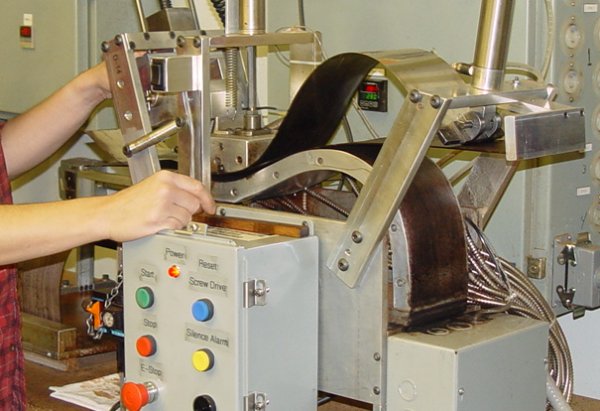

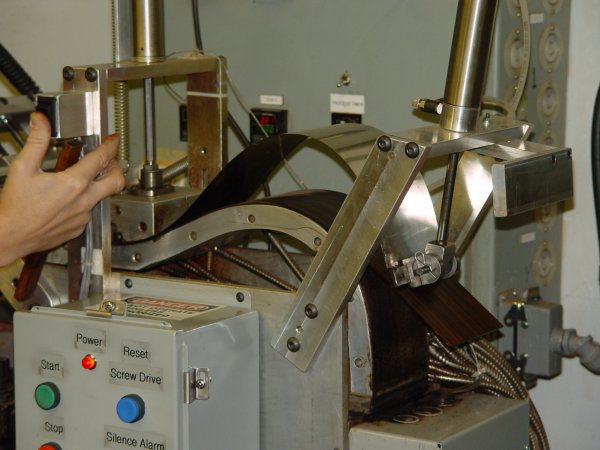

As you have read some use aluminum. but besides lack of support the big issue with aluminum is it disapates heat rapidly. so you loose about 20% (guess-ta-ment) of the heat you generate.
PostPosted: Thu Aug 14, 2008 8:33 am
Joined: Wed Jul 16, 2008 9:19 am
Posts: 48
Colin.... a further thought then.
What would be wrong with permanently fastening the bottom slat to the former?
I just revisited my photos of the Martin factory, and this is exactly what they do there. The waist is clamped down first, and then each end one at a time. You can see in my first photo that the end of the wood is still sticking out horizontally, and a ram pushes it down followed by the upper slat, as in photo 2.
Therefore the sides are bent without the wood being sandwiched between the top and bottom slat as we would do. Only the top slat moves. And of course, when it is released, there is no bottom slat sping-back to worry about.
Rod
