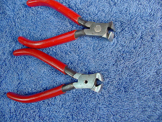

When you use the standard fret removal flush-ground nipper, you are, in effect, driving a wedge in from each side, pressing down on the fingerboard as you squeeze the handles and lift the fret. Pressing the tool against the fingerboard is a natural and good technique. But, that applies to the area where the jaws actually touch the wood, and as the fret rises, it's quite easy to pull chips in slow motion as you work your way across the fingerboard. Fret wire is kinda stiff, so it is actually raised for a fair distance beyond where the puller is working. That's where the heat becomes so useful - in the area where you can't press the wood as the fret comes out.
For really difficult situations, I have a second end nipper (the upper one in the photo) with blunted jaws so I can take a "second bite" under the fret, maintaing pressure on the board as I lift the fret higher:
As a matter of practice, though, I rely on the heat to sear the walls of the fret slot - that's what really works.
I don't know of anybody who actually grabs the fret and yanks it out, but that would certainly be a way to maximize fingerboard damage!
