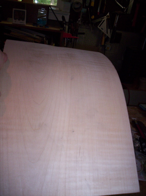

One note is that the sides were throughly dry even before resawing.
Now look at a side that was bent months ago and now looks like this. I
will need to bend it again to get it fine tuned and take care of the spring
back. There is a problem that I can see though that worries me and needs to
be addressed when I put the sides in the mold. I will need to brace across
the sides in some places since there is some natural waviness in a few
places. That is what the wood wants to do, and I now know it. I will decide if
it will be okay to cross brace it without inducing a crack years down the
road.

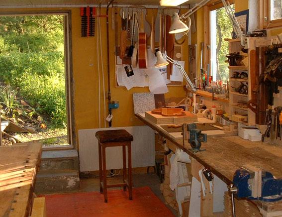

I see; you sounded like you were saying you weren't going to control the environment at all. I know most of you don't build full-time, but I think most of you are in the shop a few times per week, at which point, keeping it controlled all the time is required. But if you don't plan on being in there for a month, yes, let it go "au naturel". Even my shop's environment wasn't controlled when I was gone on vacation to the acoustic camps, but then again, it was still 68?f and 48%RH when I returned(there are -some- good reasons for living up here <g>)
I keep a hygrometer and thermometer ourtside the shop as well, as when the outdoor numbers are within spes, my door is open, also, which means most of the summer. Quite often, when I hear the dehumidifier start up, I'll glance at the outside hygrometer, and will simply open the door to dry up the shop, instead of burning kilowatts.

I do the same thing, it is nice to finally get some fresh air into that dusty shop! It is one of the nice things about living this far north I guess, the humidity swings are not that dramatic.
PostPosted: Mon Jul 03, 2006 10:27 pm
Man, i wish i had windows like most of you guys have!
