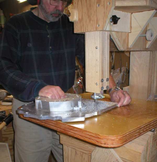

Serge - why do aluminum wheels bother you? I know some think that cast iron is better, but I can't see why. The rotating mass doesn't really affect how the machine works.
Here's a picture of me cutting the aluminum motor adapter for my electric car with my home-made bandsaw (about 15 years old now, and no problems) and it has baltic birch wheels. (two 1/2 inch discs laminated together). And the tires were cut from bike inner tubes (1.99 each)
I think the important thing is that the wheels are round and balanced - and cast iron has no advantage over aluminum in that regard.

Well, there IS a legitimate argument as to the effects of Inertia...in that it augments the horsepower of the motor. Is it measureable? Yes. I'm not an engineer, but at least to some small degree it is. Anyone who has ever seen a 36" Tannowicz in action knows just how much those large massive wheels help to drive the blade through the wood.
Gee Phil, that's some piece of work! And you made an electric car????? Wow!

Phil, i wish i had known you back in December when i asked how to build a home made bandsaw, it was my first thread and question on the forum! Do you still have the plans on how to build one?
I'd say like Don, mass is important as well as power from the motor,my now former RIDGID had cast aluminum wheels and the saw was running smooth but through some 11" Makore, it lacked a bit of force, could just be because of that lost pin though

Phil, your bandsaw is so cool, I can't believe it!!!!! I wish I had the time to
undertake a project like that. Way to go. I love it!
