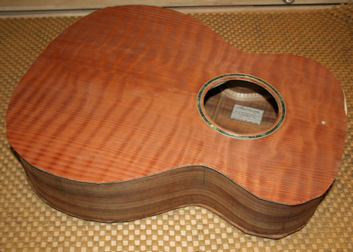

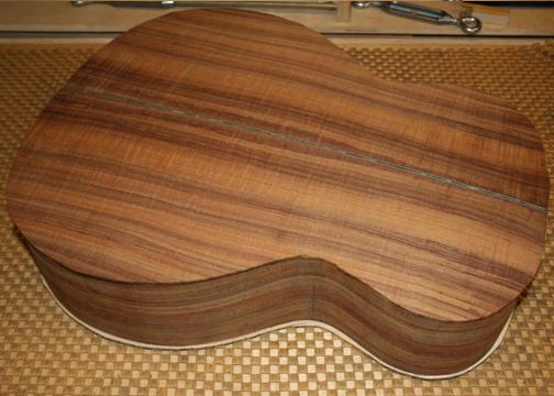

Hi guys,
here one of my latest guitars.
Curly Koa back and sides with a Semi-double Curly Redwood Top. Amazing tap tone from the box.....

PostPosted: Wed May 23, 2007 2:29 pm
Thanks for the compliments!
This is another commissioned guitar that I am working on. it will be bound with Brazilian Rosewood and the top done in Paua Abalone.

I'll go into the my semi double top details tomorrow... too late!
PostPosted: Wed May 23, 2007 5:14 pm
My gosh Peter, you know how to build glamourous but stylish guitars!!!
PostPosted: Thu May 24, 2007 2:25 am
Semi-double top construction is a simple method to strengthen figured soundboards that otherwise wouldn't be stable enough to use. All I do is trace the bracing pattern onto a spruce top that will be used as the backer for the top, then I remove wood from some of the areas surrounding the braces leaving only connecting areas to keep the integrity of the backer top. Then I glue both tops....VERY IMPORTANT....using a vacuum bag. If you don't have vacuum ability DO NOT do it as you won't be able to evenly distribute gluing pressure and may compromise the stability of the top.
